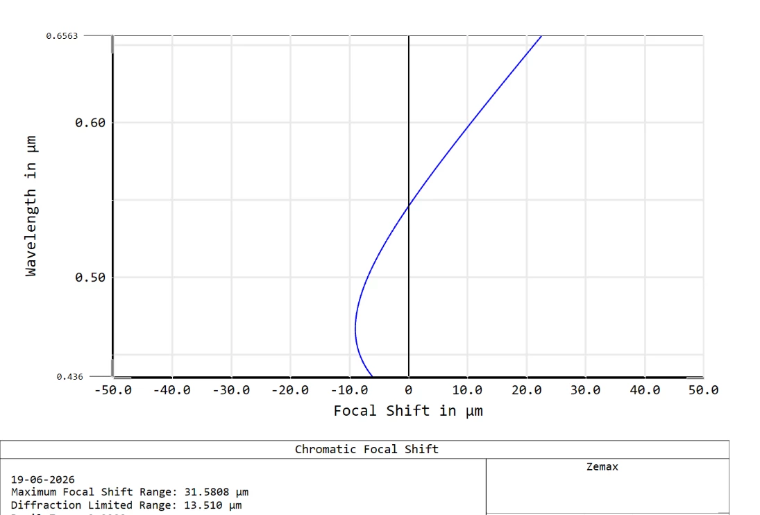

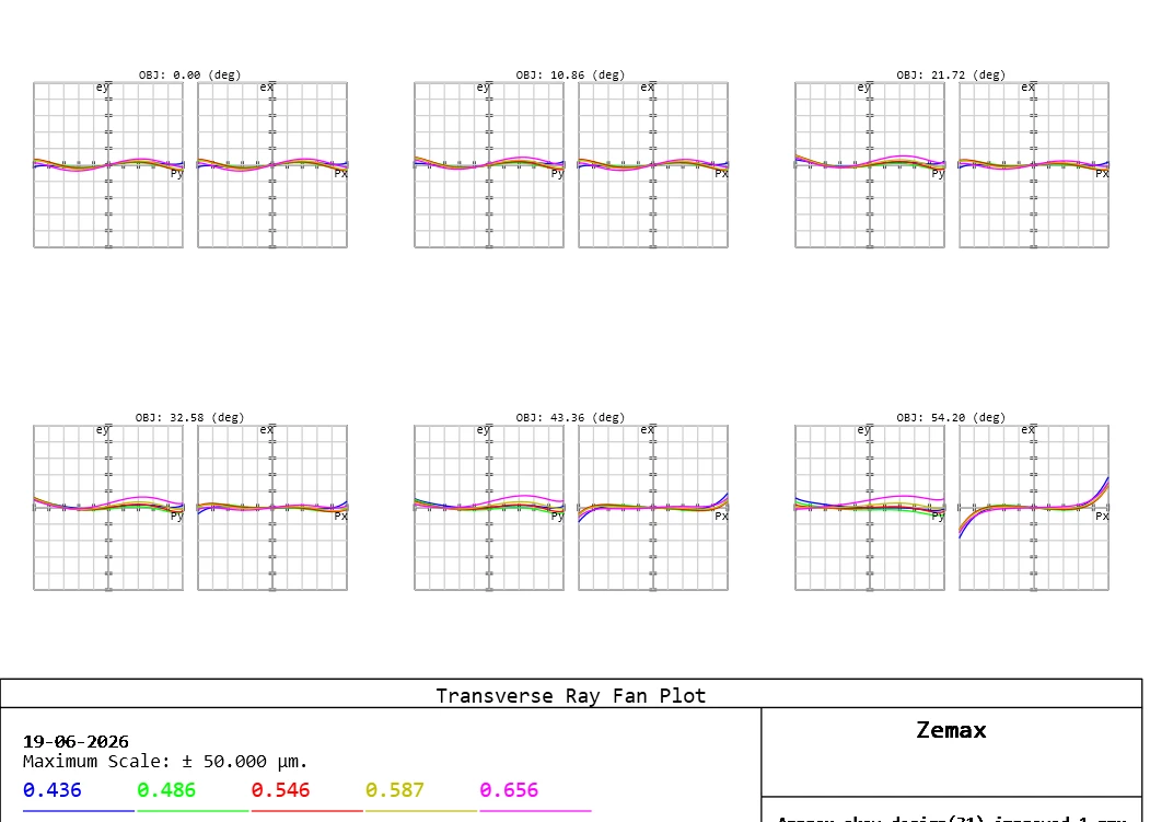

Could you show us the "chromatic focal shift" curve and the "ray aberrations" curves at the maximum field of view?

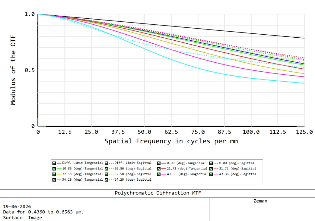

Thank you for your feedback. Here is the MTF plot. Detector size: 1/1.6 inch and current stop size is 4.5 for f/2.4 and 5mm for f/2.2. As I share the layout, the current system consists of 6 singlets, 1 doublet and 1 Filter.
BR,
Thanigachalam P

Thank you for your intense feedback. For our imaging application the small change in later color will affect chroma. Though we consider the longitudinal CA, but lateral color plays major role. I used LACL with target of 2microns for min to max wavelength change. But it doesn’t give good performance.
My pixel size is 2microns.
I tried with “Spot” optimization function with MTFT and MTFS operands to control MTF. But performance was not up to the mark.
Please review the Chromatic focal shift and ray aberration curve.
BR,
Thanigachalam P

Please could you magnify the central part of the ray aberration curves  @ max field & tangential plane (ey) ?
