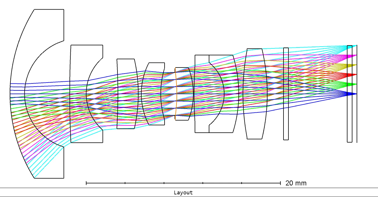

I am currently designing a low‑cost imaging lens for a sports application. In my lens model I use the REAY operand to control image height, the RAID operand to control chief‑ray angle (CRA), DIMX to control f‑theta distortion, LACL for lateral‑color correction, RSCH for spot size and MTFT/MTFS for resolution across the field. During optimization I can obtain either good MTF or good lateral color with CRA and distortion depending on the operand weightings, but I cannot find a stable balance even when I adjust the weights gradually. In both cases, my geometric spot‑size results were poor. Please suggest optimization techniques to achieve a better trade‑off, or alternative approaches to indirectly control these parameters.

Ok. understood. Can you share image of the system and the ray tracing? without knowlege of the system it will be hard to help

We will need to know more about the systmem: Field of view, stop size, effl, total length etc. Also the required prefromance. Without, it will be very hard to help. Did you try wavefront or contrast optimization?

Thank you for your continued support. Basic requirements: DFOV 110°; F-number 2.2–2.4; TTL < 38 mm; wavelength range 430–650 nm; maximum image circle 10.2 mm; front lens diameter < 22 mm (including mechanical housing); lateral color < 4 µm; chief ray angle (CRA) < 12°. I evaluated the design using contrast optimization with weighted improve manufacturing yield.

Thank you for your feedback. Here is the MTF plot. Detector size: 1/1.6 inch and current stop size is 4.5 for f/2.4 and 5mm for f/2.2. As I share the layout, the current system consists of 6 singlets, 1 doublet and 1 Filter.

OK
  • the lenses are too thick (rule of thumb : thickness ~ diameter /10). This could help for TTL.
  • are there aspheric surfaces ?
  • did you try to separate L6 and L7 ?
  • did you try to move the stop ?
  • for sports applications, do you really need 436 nm ?
  • from CFS and ray aberrations : try to increase the Abbe number of L8
  • ultimately : change the starting point. See for instance “Modern lens design”, W. Smith

  • The above layout lenses are thin lenses basically, first lens has 1.5mm thickness, expect the thickness of first lens of doublet lens, all other has less than 3mm thickness.
  • Since this is very low-cost approach, there is no aspheric surfaces.
  • Tried separating the lenses and varying the stop location using MCE individually to compare the performance.
  • Yes, the 436nm is mandatory requirement. Then only they can see clear separation between violet and blue.
  • Ok, will try to do it.
Thank you for your support and suggestion.
