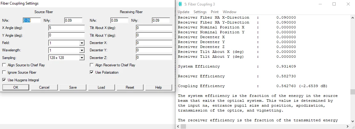

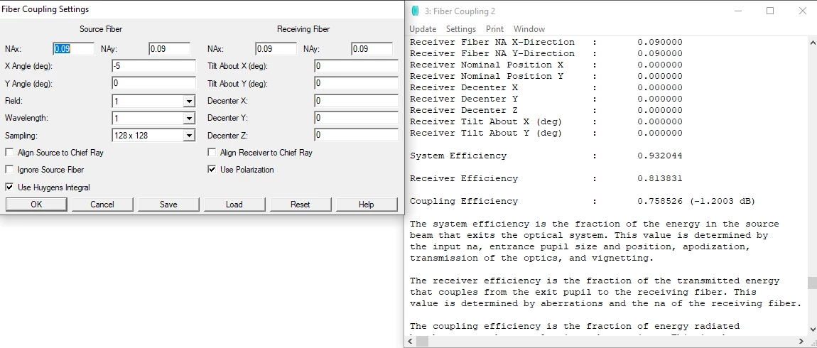

Secondly, I wanted to tolerance the system and therefore look at the effects of source fiber tilts/decenters and receiving fiber tilts/decenters. The POP allows me to just put  the source fiber decenter using the Beam data tab. where the input beam is decentered but doesnt allow me to tilt the source fiber. Therefore I go to FICL to do that, although the fiber tilt of eg:+5° is much different from what i get at  -5°. shown in the pictures attached. Since the system is having cylindrical symmetry, why do I see a change there, could anyone explain that ? For the receiving fiber however, it shows the same values for corresponding negative value of the tilt or decenter, no matter you use FICL or POP. Also for the source fiber decenteres the efficiency values are the same for corresponding -ve values of decenters. Could someone please have a look and help me out in understanding this ?
