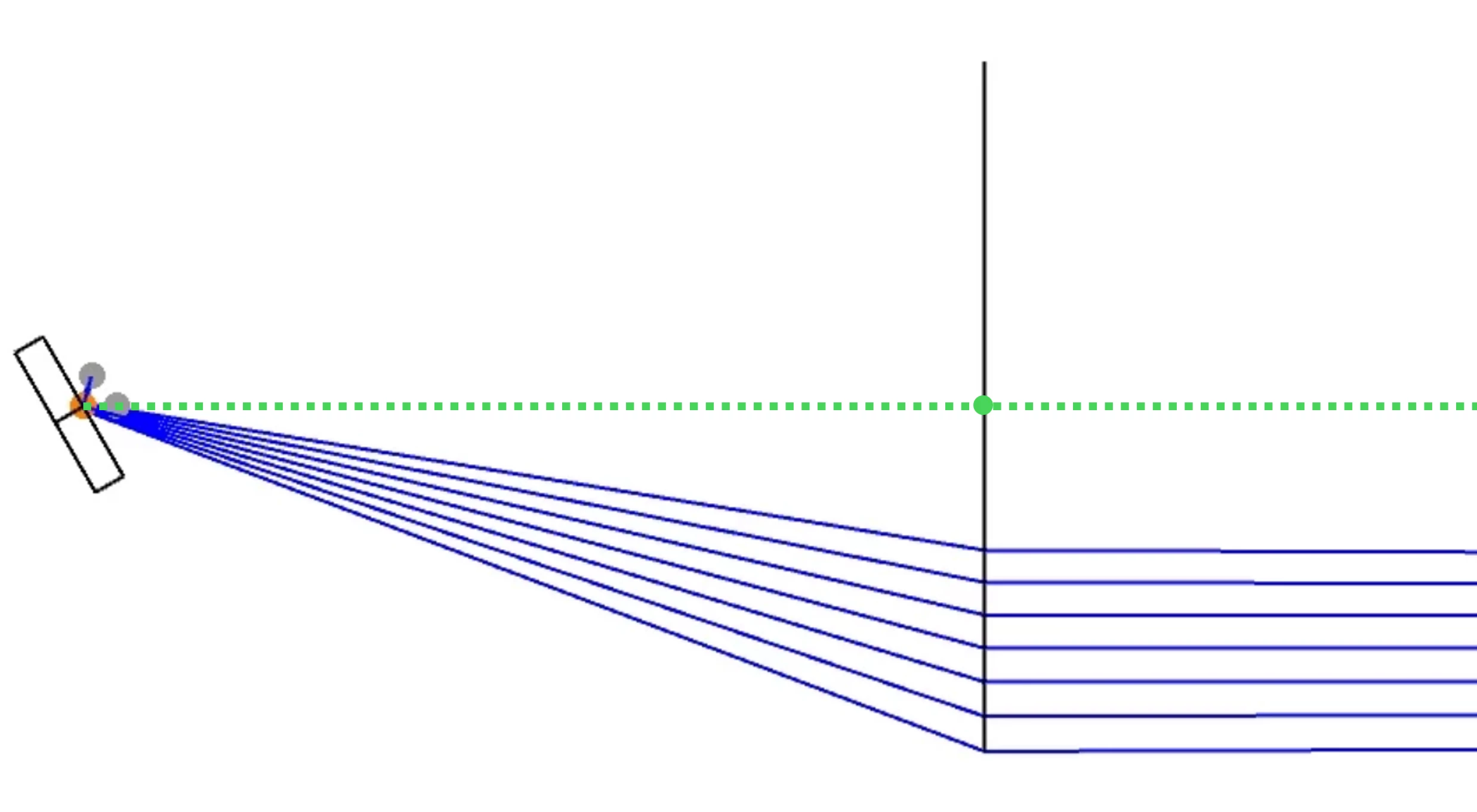

I am trying to set up the layout using a paraxial lens, but I am encountering an issue where the paraxial lens does not behave as expected (see Fig. 1).
Fig1
Fig2

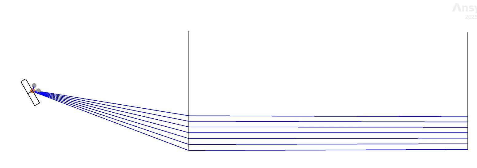

An incident ray entering the paraxial lens at an angle results in parallel rays along the Z‑axis. In a simple layout, I would expect the output rays to still have an angle with respect to the Z‑axis, rather than being perfectly parallel.
I suspect this issue may be related to the coordinate breaks, particularly around Surface 5. It seems that Surface 6 does not fully inherit the coordinate system of Surface 5, and instead still partially follows the coordinate system of Surface 0.
My understanding is that Surface 6 should be a tilted surface parallel to Surface 5, but that does not appear to be the case in my model.
Could you please point out where the settings might be incorrect for the  paraxial lens behaviors and offer some advice on how to fix this?

This time, I believe the ray tracing behaves as expected and the issue lies in how the Coordinate Breaks (CBs) are setup. I took your 3D Layout, reduced the number of rays to 3, made the first mirror the Global Coordinate Reference and put a X Rotation of -90 degrees in the 3D Layout setting. I then overlaid three axes: the blue dash-dot-dash axis is the original optical axis of the system. With the first coordinate break, you tilt it by +45 degrees and it becomes the dotted pink axis. After the mirror, you tilt it again by an additional +30 degrees (dashed green axis).
Therefore, it makes sense that the rays are parallel to the optical axis after the Paraxial surface. As you can see the rays are all starting on the optical axis (one focal distance away), and so they come out of the Paraxial surface parallel to the optical axis.

About the paraxial (collimator) lens: if the Chief Ray Pickup solve is used, the correct exit ray angle can be obtained. However, if the Chief Ray Pickup is not used and the paraxial lens is located without any decenter relative to the Z‑axis, I obtain the exit ray angle shown in Fig. 1 (parallel to the axis).

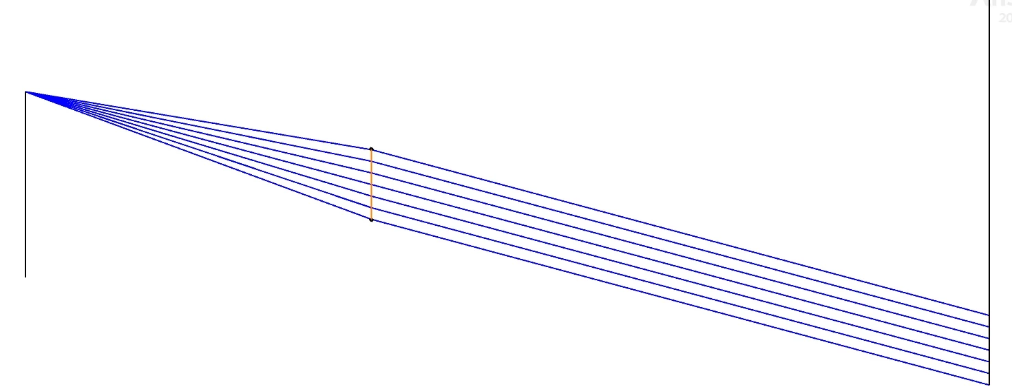

My assumption was that the exit ray angle should be similar to what is shown in Fig. 2, since the incident angle onto the paraxial lens is 15 degrees.
If this understanding is incorrect, could you please help me identify where my reasoning is wrong?
Fig2

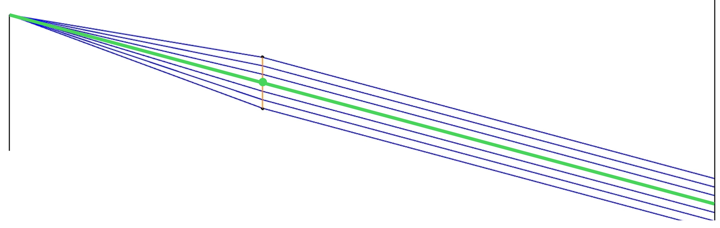

Let’s keep it simple. If you have a Paraxial lens, remember that only the ray that passes through the very center of the lens is undeviated.
In Fig2, I added a green circle to show the Paraxial lens center, and you see that the ray that crosses this very center is going straight, it is not bent by the lens.
However, in Fig1, you can see that you currently don’t have a ray going through the center of the Paraxial lens. However, we can construct such a ray (dashed green ray). And because all rays are emitted from a single point in the focal plane, they must all come out parallel.
