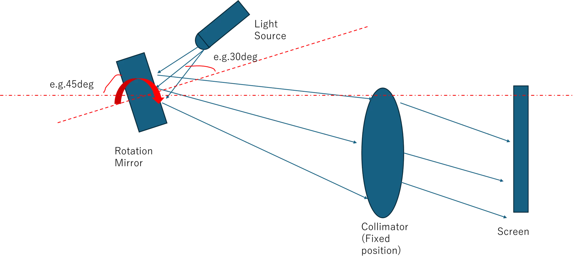

Hi Zemax users,
I am trying to set up a lens system layout as shown below, but I am confused about the following points:
  1. Why does the direction of the Fletch arrows reverse?
  2. Why does the paraxial focal length of the lens not seem to work as expected?
I have attached my data. I would really appreciate any help.
Could you please point out what I am doing wrong?
Expected Layout and Fletch Arrow direction
Attached Zemax Data
Best Regards
Yang

I’m not totally sure, but I think both issues are related to the fact that you initiate the ray trace in a backward direction by having the first non-zero thickness negative in a “non-mirrored” space.
If you add a surface after the OBJECT and make its Material mirror, then the “positive” propagation direction becomes negative, and the arrows point in the right direction.
This is the same reason the Focal Length wasn’t behaving as expected as well.
In general, I think you want positive thicknesses until the first mirror, then switch to negative thicknesses until the next mirror, and then alternate the signs between mirrors.
I hope this helps.

Hi David,
Thanks a lot!
That’s exactly what I wanted to do. I initially thought that using a negative thickness would make the fletch arrow point in the intended direction.
Thanks again for your explanation—not just this time!
“ In general, I think you want positive thicknesses until the first mirror, then switch to negative thicknesses until the next mirror, and then alternate the signs between mirrors.”
Best regards,
Yang

@David.Nguyen
Hi David,
Thanks a lot for your comments, and sorry for bothering you again.
I am trying to set up the layout using a paraxial lens, but I am encountering an issue where the paraxial lens does not behave as expected (see Fig. 1).
Fig1
Fig2
An incident ray entering the paraxial lens at an angle results in parallel rays along the Z‑axis. In a simple layout, I would expect the output rays to still have an angle with respect to the Z‑axis, rather than being perfectly parallel.
I suspect this issue may be related to the coordinate breaks, particularly around Surface 5. It seems that Surface 6 does not fully inherit the coordinate system of Surface 5, and instead still partially follows the coordinate system of Surface 0.
My understanding is that Surface 6 should be a tilted surface parallel to Surface 5, but that does not appear to be the case in my model.
Could you please point out where the settings might be incorrect for the  paraxial lens behaviors and offer some advice on how to fix this?
Best regards,
Yang
@Yang.Yongtao
This time, I believe the ray tracing behaves as expected and the issue lies in how the Coordinate Breaks (CBs) are setup. I took your 3D Layout, reduced the number of rays to 3, made the first mirror the Global Coordinate Reference and put a X Rotation of -90 degrees in the 3D Layout setting. I then overlaid three axes: the blue dash-dot-dash axis is the original optical axis of the system. With the first coordinate break, you tilt it by +45 degrees and it becomes the dotted pink axis. After the mirror, you tilt it again by an additional +30 degrees (dashed green axis).
Therefore, it makes sense that the rays are parallel to the optical axis after the Paraxial surface. As you can see the rays are all starting on the optical axis (one focal distance away), and so they come out of the Paraxial surface parallel to the optical axis.
I am not sure what is the intended behavior of the system, perhaps you could clarify how the different elements should be positioned with respect to one another.
One possibility is to center the Paraxial surface on the chief ray using a solve. For that, I added a Tilt/Decenter to the Paraxial surface:
The result is as follows:
I am attaching this modified file to my reply. But then again, I’m not really sure if that’s what you want.
Hopefully that answers some of your questions.

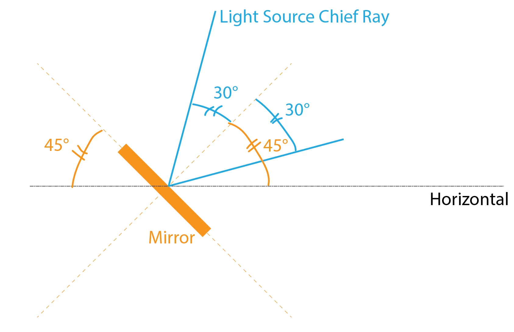

  • April 9, 2026
Hi David,
Thank you very much for your reply and for sharing the data.
What I am trying to build is the system shown below.
As a first step, I tried using a paraxial lens, and that is where I encountered the issue we have been discussing.
I am still confused because the 30‑degree tilt does not seem to work as expected. For the paraxial surface, I would expect the incident ray angle to be 15 degrees (i.e., a mirror tilted by 45 degrees minus a light source tilted by 30 degrees).
I am still working on this issue, but I would greatly appreciate it if you could share any advice or suggestions.
Best regards,
Yang
@Yang.Yongtao
Your drawing is a bit confusing to me, I think it is because it might not be drawn to scale. If the light source chief ray is 30 degrees from the mirror normal, and the mirror is tilted 45 degrees from the horizontal then the reflection is opposite (w.r. to the horizontal) to what you have drawn. Is that right?
In your drawing, the chief ray has an incidence angle of 30 degrees on the mirror, therefore, it is reflected at 30 degrees from the normal. I am not sure what you are referring to with those 15 degrees. The reflected ray makes an angle of 15 degrees with the horizontal.
Please correct me if I misunderstood what you are trying to achieve.
However, one thing that is different in your latest drawing is that the collimator is not centered on the horizontal axis, which was your optical axis. I think it is important that you consider the lateral position of the Paraxial surface, and that’s what I tried to show with the Chief Ray Solve.
Let me know if this helps and take care,
