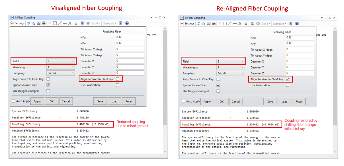

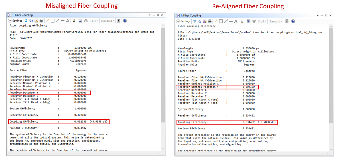

I took a look at your model, and everything looks okay to me.  Your paraxial magnification is -4.16, so a +1 micron lateral shift of the source point leads to a -4.16 micron shift of the image point.  Your fiber, however, remains static, so it becomes misaligned and the coupling drops.  The core diameter for an SMF with NA = 0.12 at 1550 nm is ~ 8.2 um.  So, a 4 um shift is a significant misalignment.  (Note: the Huygens PSF is always centered on either the chief ray or the spot centroid, so you will not see the spot shift reflected in the position axis of the PSF cross section.)
If you want to see what the coupling is when the fiber is translated to the chief ray location, then you can check that option and see the result:
You can see where the fiber is located by looking at the data in the Fiber Coupling tool.  The “Align Receiver to Chief Ray” shifts the fiber location and therefore restores coupling:
