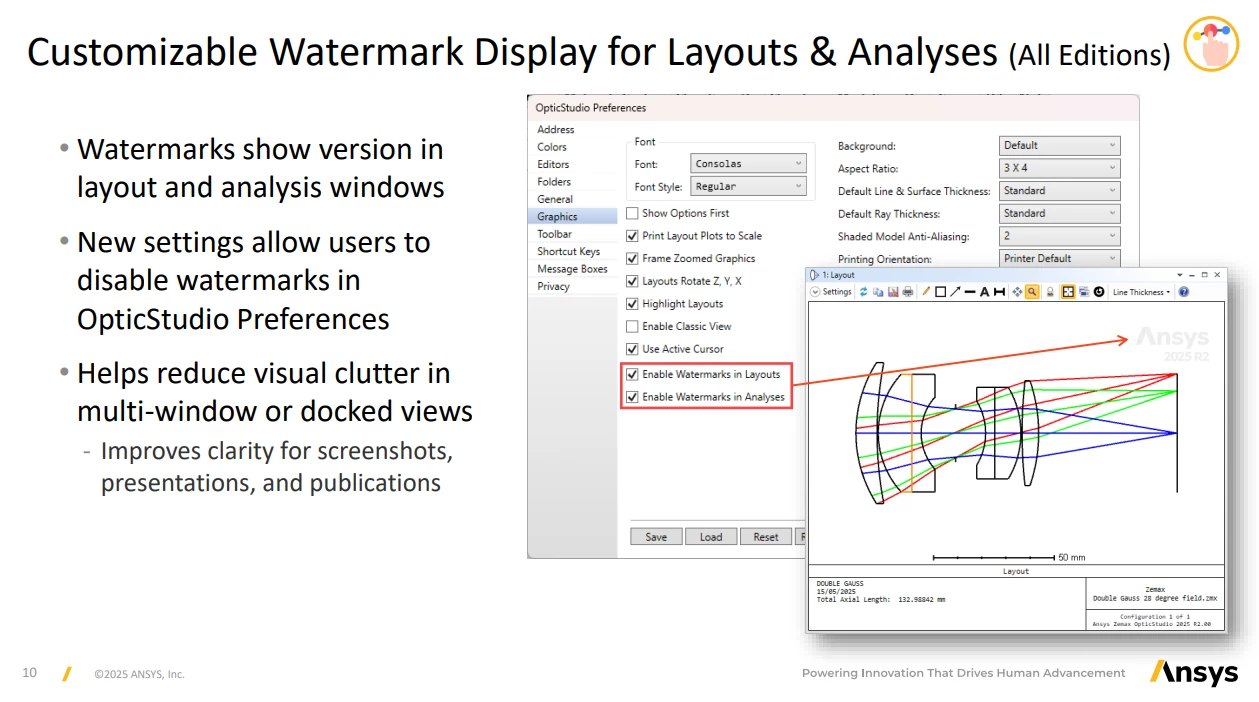

How do I turn this off? We pay to use Zemax, not to be an advertiser for Ansys.

Solved in version 2025 R2.00.

But unfortunately when you save the file I still get the water mark, even with them turned off so they do not show on the graphics! Can we turn them off for the files too???
