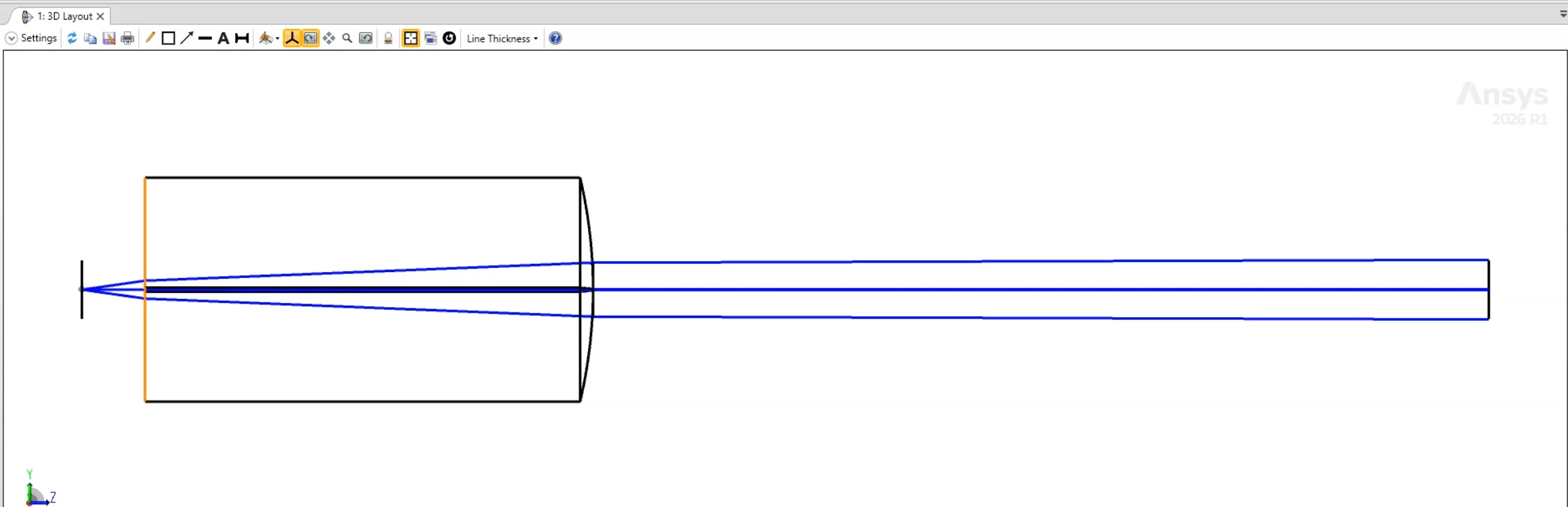

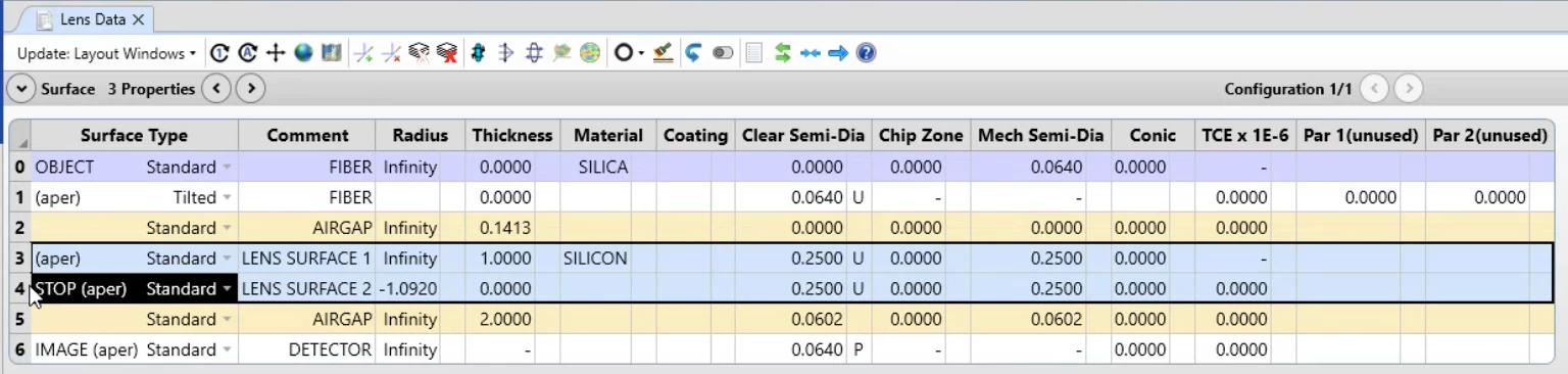

Using Tilt/Decenter tool crashes the LDE. Example LDE setup as shown below.
LDE
Cross-Section
CX
I have tried:
# Added Dummy surfaces before and after Surfaces 3 and 4 and use that as START/STOP in Tilt/Decenter tool → Still Crashes.
# Changed wavelength from IR to VISIBLE and use N-BK7 instead of SILICON → Still Crashes
# Used ZERO for all TILT and PIVOT values → Still Crashes
PS: I have opened a Support Case in parallel. Will keep you folks updated on what Ansys says.

​@Asuku:
You have operands in your tolerance data editor that refer to surfaces that don’t exist.  Delete all tolerance operands and try using the Tilt/Decenter tool again; it should work.
Also, when I ran a System Check on your file it came back with an NSC warning.  When I looked at the .zmx file in Notepad, I also see NSC detector settings.  So at some point it looks like it contained some aspect of an NSC model.  If I were you, I would start over with a fresh sequential model.
