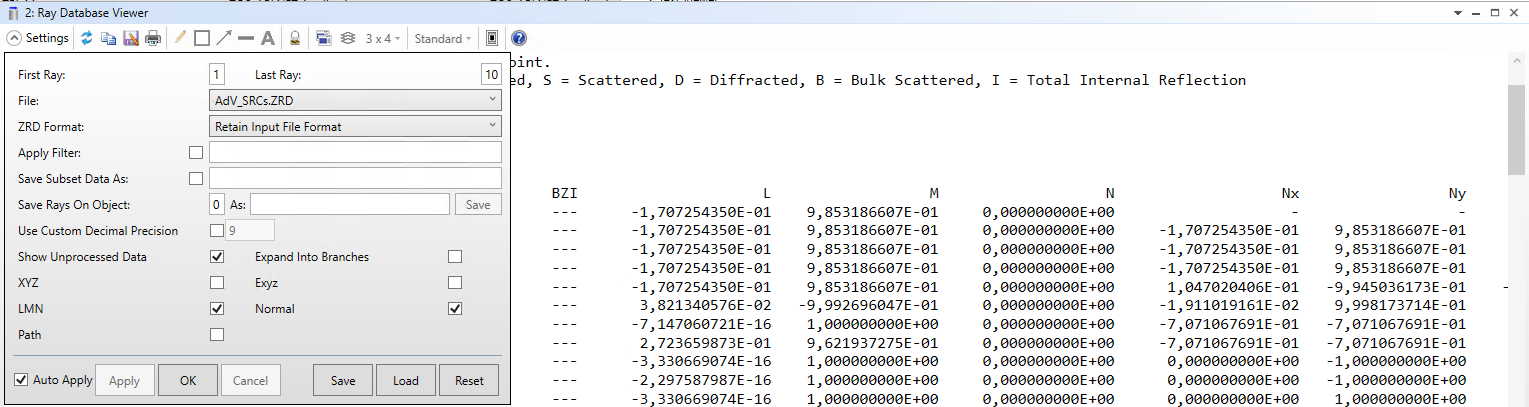

Francesco.Flocco
Hi, I have the same problem of ​@Önder.Sönmez, in the Ray Database Viewer the values of the director cosine LMN are lower than 1:
while the ones displayed on the text viewer after running the shared macro are greater than 1 (same identical situation with values that seems integer):
At the end the calculated AOI from the macro are wrong.
To set the RDV I have followed the instructions of ​@Allie and ensuring that I pick the correct window (as can be seen in the picture), but didn’t work for me. I’m also using the zmeax version 2025 R1.01.
Hoping I’m not too late, if someone can help it would be fantastic.
Ansys Staff
  • Ansys Staff
  • 402 replies
  • July 15, 2025
@Francesco.Flocco This ZPL uses SVAL rather than LVAL.  So, when the macro tries to parse -1,707254350E-01, the macro only sees -1 and ignores everything after the comma.  There are 7 instances of SVAL and if you change all these to LVAL, then the macro should work.
