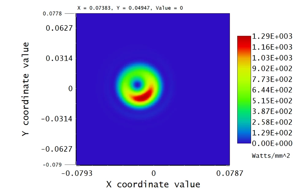

Hi ​@Michael Cheng,

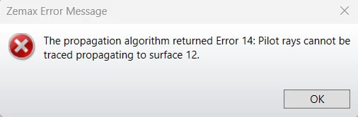

    I download your vortex phase plate .dll file and used in my optical system model, however, it results in a non-symmetrical, off-axis doughnut beam patterns like follows. Since I used LD source light coupled into a SMF with APC connector (8-degree), I tried to eliminate such connector tilt angle impact on output beam patterns, so I tune the fiber end-put surface to vertical with zero angle, then I noticed the following error screenshots. I am not sure if I set anything incorrectly in the attached .ZAR file, so if you or someone can help take a look, it would be greatly appreciated,

  • Dec 3, 2025 1:11 AM UTC
Hi lijia2025,
I downloaded the file and update the system, but I don’t see the error message. I think this is more specific to a system, which needs more investigation. I would suggest sending this to support team so we can help to have more check.

lijia2025

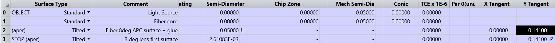

  • Dec 3, 2025 1:23 AM UTC
Hi Michael,
   In my uploaded model, if you modify y-tangent of fiber APC 8-degree angle to zero, indicating a symmetrical incident beam case, you would find the above error message.
